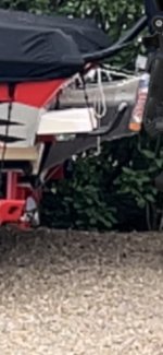

I am currently running a 400R / Sportmaster with a Lab finished Cut down and worked over Maximus 5 with 14" of set back. Aired right out I am getting jus over 85 MPH. I have eaten up a few of these props while surfacing, tearing ears and in one case pulling the hub apart. I am currently repowering the boat with Merc Racings new 500R and I am looking to run the 500HP CNC cleaver from mercury. Has anyone experimented with a Pulsare 2400 with the 1.60 gear ratio gear case on either a 450R or a 500R yet. Looking for a good starting point.

Thanks for the reply! On the 400R the prop I started with was a 24 pitch Maximus 5 The prop diameter was cut back, the hub was shortened back to remove the bell, and a substantial amount of cup was worked into the blades along with tip cupping to increase bow lift, sharpened and balanced. After all of the work was done to the prop it is probably close to a 26 pitch. What I can tell you is that increasing the setback of the motor brought my top speed up by 7 +/-MPH, Inches of setback with the BRX = MPH.
What is your Engine, setback, prop combination that you run to get 83 MPH? Have you tried a CNC cleaver? The best top end I have seen on prime choppy conditions running in cool dense air was 86.3 MPH.

My 83mph was done with a 25” BBlades Blaster and at that time I had 14” of set back, I didn’t like the amount of porpoising it had while at normal cruise speeds with that set back, constantly had to fiddle with the trim to try and get it stable, so I switched out and went to 6” and now it’s true and smooth in all conditions. I haven’t tried any CNC cleavers yet but I was thinking of talking with Dewalt and see what prop would get me back to 83+ with my current set back. Do you already have the 500R? That is going to be a pretty awesome set up, I was considering a 450 for a while but the prices for used haven’t come down much and still not may used ones out there yet so instead I might look into a tune my 400
