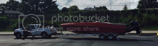

As many of you know, I picked up 2tonchevy's 2800SX and will begin the process of finishing what he started as well as making the boat what I want. I will start with the few pics I have so far, but will get more posted as I get to it.
First up - I need to get the boat in full working order. The port side midsection is broken - The boat came with a new mid to replace the broken one, but it still needs to be installed along with reinstalling the lower unit.
Second up - The starboard side hydraulic steering ram is leaking, so that will need to be rebuilt. I plan to send both of the rams back to Latham to have them rebuilt.
Third on the list is finding latches for the drop out bolster seats. The seat and hinge are intact but there is no latch to hold it up. Any suggestions on where to look would be appreciated!
